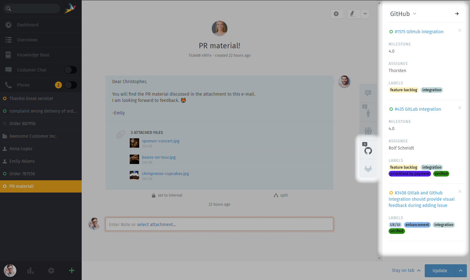

View Linked Issues¶
Open the GitHub or GitLab tab in the ticket sidebar of a ticket that
already has issues linked. Each entry starts with an icon for the issue state,
followed by the issue number and title. Click the title to open the issue on
GitHub or GitLab. Each entry also shows the issue’s Milestone, Assignees
and Labels. GitHub issues show a Type as well. A field appears only
when the issue has one. The badge on the tab counts all linked issues, not
only the open ones. Zammad reads the state when the panel loads and doesn’t
watch the issues, so no notification is sent when an issue changes. If the
panel shows Loading failed. instead of the issues, ask your administrator
to check the token.
