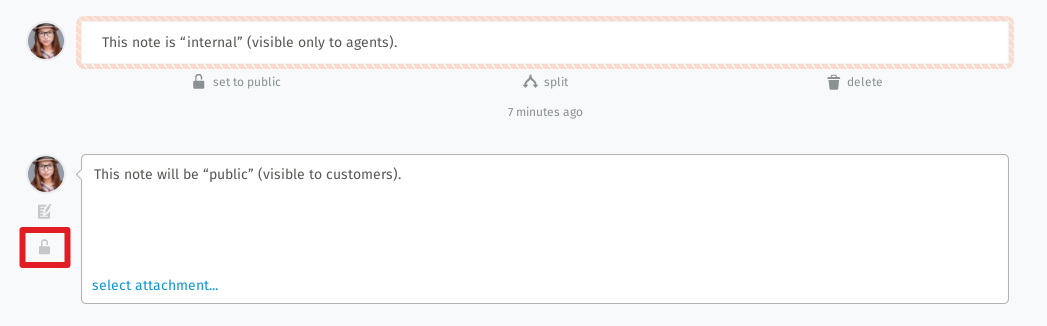

Click the lock button 🔒 to change an article’s visibility. Internal visibility appears as a dashed border in a pale red color.
Screenshot shows article editor with highlighted lock button to change visibility of article.

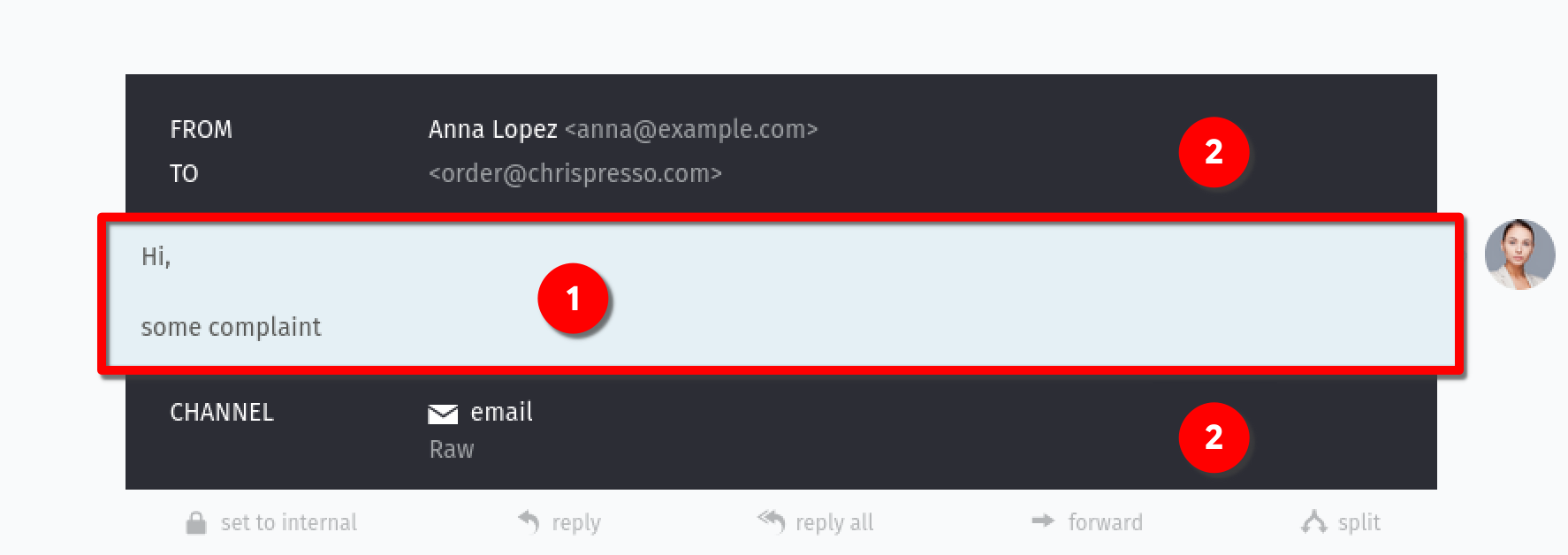

Every new article appears at the end of the conversation, which means below the existing articles. To see detailed information of a message, just click on an article (1). This opens additional meta information (2):
Screenshot shows article detail view.

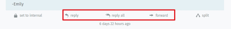

To forward or reply to an article, use one of the response buttons under an article. The behavior is similar to an email client.
  • Reply: Allows you to answer the article. The recipient is automatically pre-filled. The reply is sent via the same channel as the original message. This lets you easily send an answer to a customer or third party, if involved.
  • Reply all: Same as above but uses all recipient addresses from the original message as recipients for your new article. Only available for email channels.
  • Forward: This means you can forward the original message to a third party or anybody else. The original message and attachments are included in your new article.
Screenshot shows response buttons below an article.

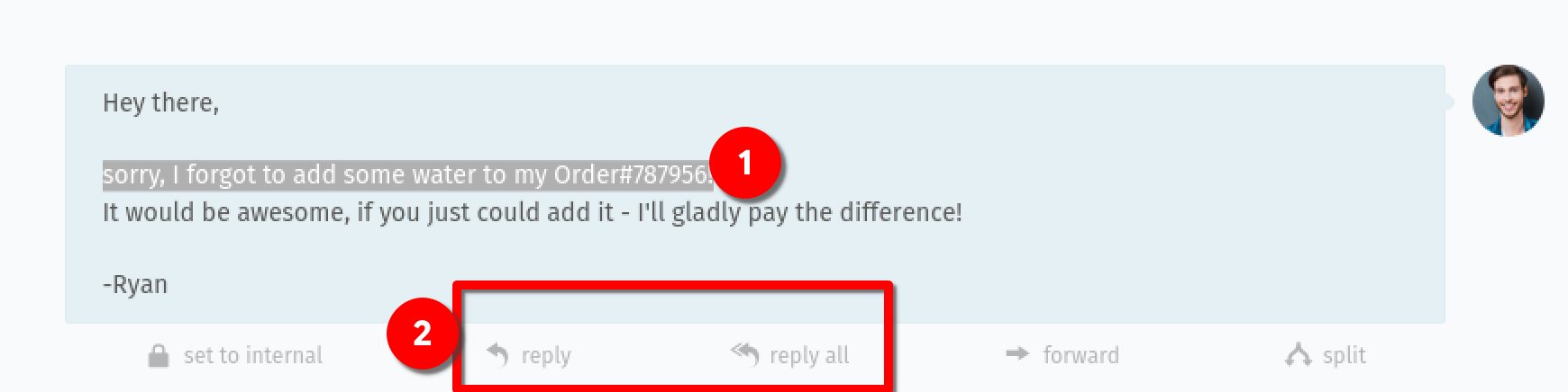

Zammad even allows you to quote text from an existing article. This is especially helpful if an answer refers to different parts of the original message or the text is pretty long. This feature is limited to communication type articles like email where the response buttons are available.
To quote text, simply select the text you want to quote (1) and use the Reply or Reply all function (2):
Screenshot shows article with marked text and highlighted reply actions.

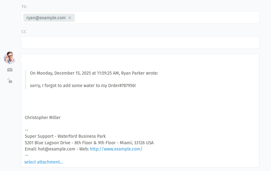

This adds the marked text with a timestamp in your article editor where you can answer it. Example:
You can use the quoting even multiple times to quote different parts of the text. Just select another part of the text, click on the same response action as before and it gets added as another quote to your editor. You can split quotations by using enter or shift + enter in the editor.

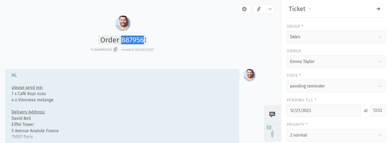

Rename a Ticket
To rename a ticket, simply click on the title in the header bar and start typing. This title is used as subject in email communication and shows up in several places like overviews.

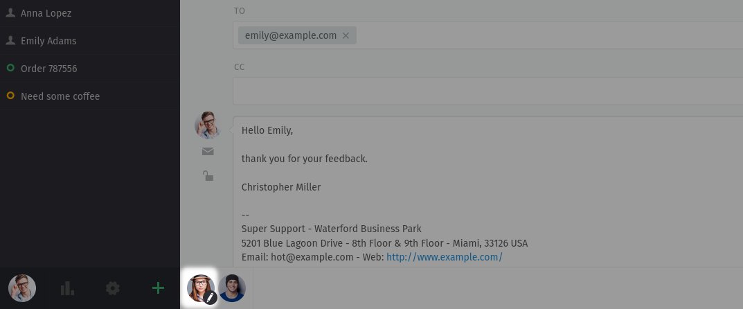

It can happen that two or more agents open a ticket at the same time. To prevent edit conflicts and customers receiving contradictory answers, Zammad shows you who is viewing or editing the ticket currently. You can find this information in the bottom bar where avatars of all agents are displayed. Be sure to communicate with your colleagues to prevent these problems before they arise.
Depending on the additional icon and if the avatar icon is faded, it means:
  • Avatar: Another agent is viewing the ticket.
  • Faded avatar: Another agent opened the ticket but is currently not actively viewing it.
  • Avatar with pencil icon: Another agent is currently actively working on this ticket.

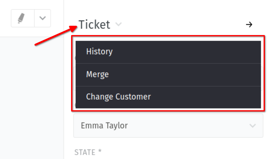

Additional actions are available in the ticket submenu. You can find it in the ticket sidebar. To open it, click the Ticket heading to access additional actions.
Ticket submenu
Geçmiş
See a comprehensive list of updates to the ticket, performed by any user, since its creation. Useful to check who did what and when.
Birleştir
Migrate all messages/notes to another ticket. Useful if you have more than one ticket about a single customer issue. See merge tickets page for details.
Müşteriyi Değiştir
Bileti başka bir müşteriye yeniden atayın.

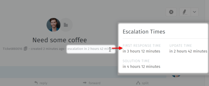

Service Level Agreements (SLAs) ensure timely responses to customer requests. Your administrator sets these goals - such as responding to all inquiries within eight hours - with optional custom deadlines for specific customers. When such a deadline is passed, the ticket escalates.
Zammad notifies you by default when tickets approach or exceed their deadlines. Configure these notifications in your profile settings. Zammad also ships a default overview called “Escalated Tickets”. This overview includes already escalated tickets and tickets which are expected to escalate within the next 10 minutes.
SLA-relevant tickets display a timestamp in the ticket detail header. Hover over this timestamp to see all escalation stages and deadlines in a popup. It shows all upcoming or reached escalation times based on your SLA configuration:
Screenshot showing hovering over escalation note and getting more detailed escalation information.
İpucu
The escalation times are calculated based on your business hours. This means when your business hours start at 9:00, a ticket is created at 7:00 and you have an 1-hour deadline, it will escalate at 10:00, unless resolved earlier.
The SLA feature requires a configuration from your admin. In case you don’t see escalation timestamps, either the ticket is not SLA-relevant or the feature is not configured. Admins can refer to the SLA configuration documentation.

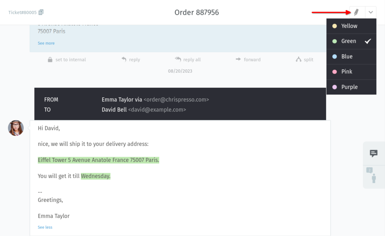

Use the highlighter tool in the upper right corner to mark up important text. This feature is not about highlighting text in the editor to send it to customers. It is just about highlighting important parts for other agents.
First select the text you want to highlight, then click on the highlighter button with the pencil. In case you want to use a different color, open the color menu by clicking on the down arrow in the split button. To remove the highlighting, click on the button again with the selected text.
Ticket highlighter
